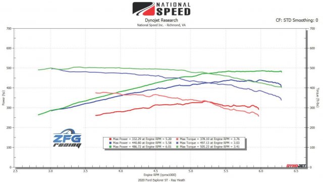

I'm going to give you a dyno chart. This is a completely stock ST with just a ZFG tune. With 93 octane, you'll see a nearly 100HP gain in performance. With E50 tune, nearly 150HP gain.
It doesn't take a huge leap of logic to realize that if the stock exhaust and intake can support that level of performance, that there aren't any exhaust or intake mods that are going to make any appreciable difference until you exceed those horsepower levels.
Now, if you swap the turbos (and I'd also swap the downpipes at that point), you might find that there might be some more performance to be found from changing the intake an exhaust.
As far as an intercooler, it might not make a big difference in a single 1/4 mile pull, but it will allow you see more consistency in the intake manifold temperatures which makes it a must have IMHO.
These come stock with 400hp, how did this one start at 332??
I Bleed Ford Blue
792
553
23 Rapid Red Explorer ST
The 400 is at the flywheel, the 332 is at the wheels, there is drivetrain loss.
5,021
6,011
Drivetrain loss…Google it.
Mfg’s use crank HP. Enthusiasts use wheel HP. They are not the same thing.
