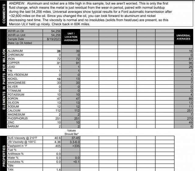

Got my results back after 54k miles and the fluid was fine....

Gotta love Blackstone…making people worry about nothing for decades. lol
