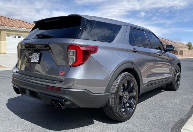

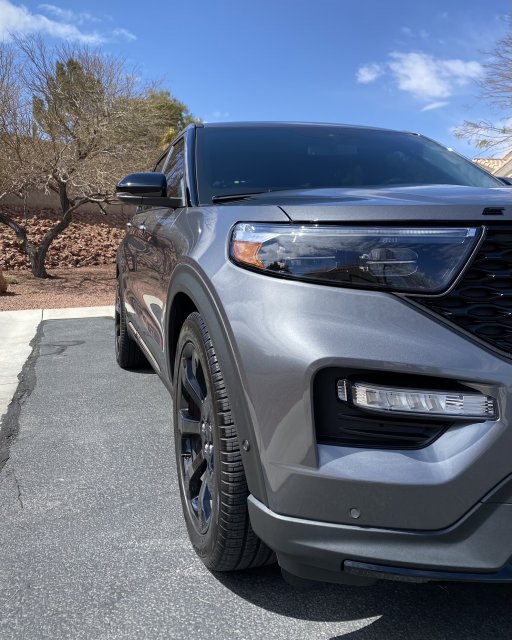

Here’s mine with Steeda 1.25” spacers on the rear only, as well as Steeda springs. Didn’t like the idea of cutting studs, and 1.25’s on the front poked out a little farther than I liked so I ended up with this.
