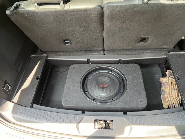

Not sure what they mean by a harness but most people are using the Audio Control LC2i to grab the signal from the factory subwoofer wires and then to the amp. I used a NAV TV ZEN but I changed out all my speakers. I'm using this Alpine subwoofer that fits perfectly in the storage compartment. It's plenty loud enough for me.
