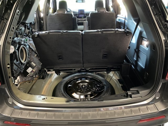

Getting the Signal
I tapped the existing sub for the line-level inputs into the amp. (Again, keep in mind this is for a 2020, and I'm not responsible for whatever work-slash-damage you do to your Explorer). There are two sets of wires that feed the OEM sub (it's a DVC [dual voice coil] sub), these are the colors of those wires:
  • "SUBWOOFER 1" (I used as Left channel)
    • positive (+) = Green/Violet wire
    • negative (-) = Gray wire
  • "SUBWOOFER 2" (I used as Right channel)
    • positive (+) = White/Blue wire
    • negative (-) = Blue/Green wire
This is the location, in the BLUE circle:

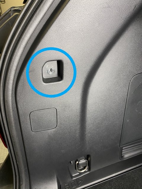

Removing Trim Panels to Access OEM Sub
Here's the panels that I removed to get access to the factory sub and wiring (and the fastener locations on the backs of the panels, so hopefully you won't break any!).

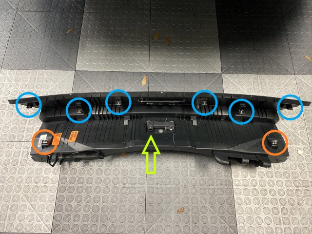

Pop out the ORANGE fasteners first. Then pop out the BLUE ones. Disconnect antenna at the GREEN ARROW. In this picture, the hole where the liftgate latches is at the TOP.
Remove the rear arm rest first (ORANGE outline). Ignore the BLUE outline for now, we'll come back to that later.
Remove by starting at the cup side. Pull up to pop out the fasteners. The 3 fasteners circled in ORANGE were very, very tight for me. So you may have to yank on these pretty hard. Say a little prayer to the Plastic Gods of ABS.
Once the panel is out, this will expose the 3rd row seat belt anchor bolt. 15mm I think it was. Unbolt it. Torque Specs for re-install: 35 lb. ft.
Note: There is a spot that looks like a fastener is missing, next to the yellow fastener. It's not missing, there isn't one there (which is why it isn't circled in the image). So don't sweat it.

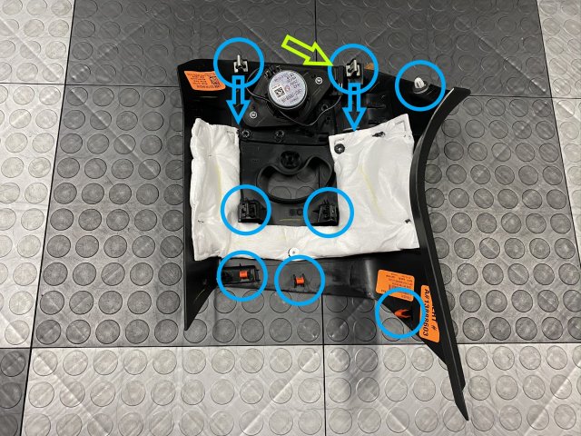

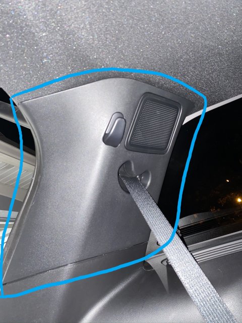

Next is the D pillar:
Pop all the fasteners free circled in BLUE - but do NOT remove the 2 BLUE ARROW fasteners. Once all the other fasteners are free, slide the whole panel down, in the direction of the BLUE ARROWS. Those two fasteners will just slide out, you do NOT need to pull on them to remove. Don't forget to unhook the speaker at the GREEN ARROW.

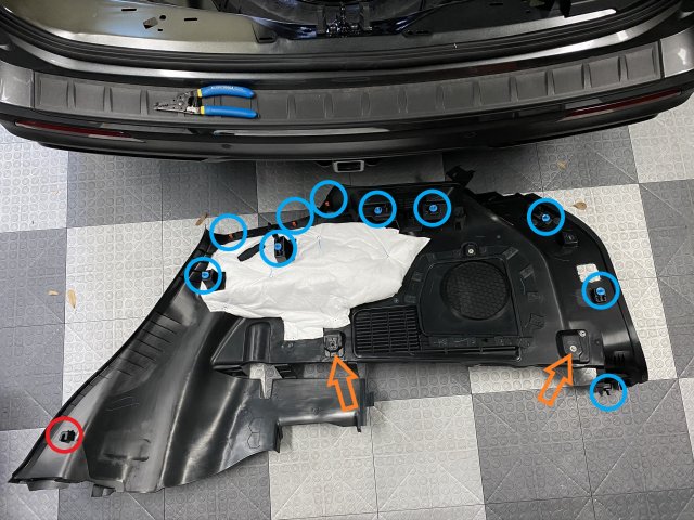

Okay, now back to this guy. We are removing the BLUE outline.
NOTE: The little cargo clip things - they do NOT pull out. They are in fact screws. Get some pliers with tape wrapped around the jaws, grab on the little cargo hooks, and then UNSCREW them like you would any normal screw. If you pull on them, you WILL break the little clips (and it still won't come out).
There are two silver cargo hooks located at the bottom of the panel (ORANGE ARROWS). Flip up the plastic cover from the bottom to expose the bolt that hold these in. Unbolt them. 8 or 10mm I think they were. Torque specs for re-install: 44 lb. in. (NOTE that is "lb. INCH", not lb. ft.). There are little captive washer things on the backs of these bolts, which makes it hard to tell if they are completely unbolted. Also, the captive washer might come off and fall down into the depths of the body seams. If this happens, no big deal. They aren't necessary.
The RED circle looks like there should be a fastener there, but on my vehicle there wasn't one.
The majority of the fasteners are along the top of the panel. Just go slow, popping them out. I started at the edges and worked towards the middle.

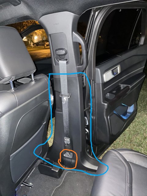

Okay. The next step is to route the high-level input speaker wire from the amp that is installed under the passenger seat all the way back to the OEM sub signal wires. I chose to route these back along the passenger sill plates, under the 3rd row seat, over to the OEM sub. To remove the 3rd row seat, it comes out with two bolts (18mm I think, Torque specs for re-install: 35 lb. ft.) and it weighs like only 5 pounds or so - it's surprisingly light.
Keep in mind that there is an airbag in the upper B pillar. I only popped off the lower trim panel and didn't mess with the upper portion/airbag. If you do decide to do that, be careful. You should also disconnect your battery. It's not necessary though for this install.
This where I started:
I forgot to take a pic of the fasteners on the underside. Sorry about that. Using the picture above as a reference, there are two at the left most edge, two more along the middle towards the front, and then two more at the top of it next to the door. There are NO fasteners on the part that sits in the foot well.
Remove the seat belt attachment cover (ORANGE outline) first. It just lifts up and out.
It looks like I might have forgotten to circle the clip over there on the right side. Not sure, and I don't remember :( So just FYI, that might be a clip as well.

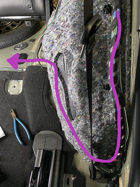

With that done, here's how I routed the wires. For the trim panels that I left in place, I just tucked the wire up under the edges. Follow the PURPLE line for my wire routing:
And Bob's your Uncle. That's it for input signal to the amp. I recommend leaving everything apart for now until you get the amp and everything hooked up and tested. Once you know it works. then we'll talk about reassembly.

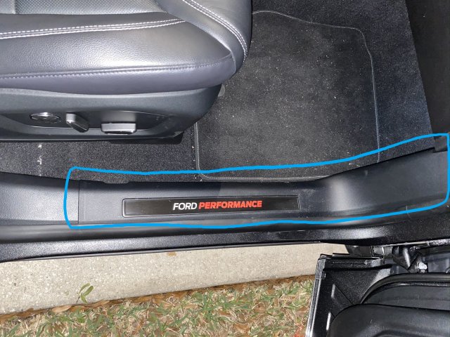

The Ground is the easiest of the two, so we'll start there. I'll show you where I put the ground, but you are welcome to put it wherever you want. Just make sure that it's a good ground to the chassis (this is a unibody vehicle), that you clear away any paint so there is bare metal contact, and that you make the Ground connection as SHORT as possible.
This is where I elected to install the ground. There's a nice flat spot exposed when the passenger sill panel is removed, and no plastic bits from the trim piece get in the way. The location is here (I added/drilled the hole at the BLUE ARROW):

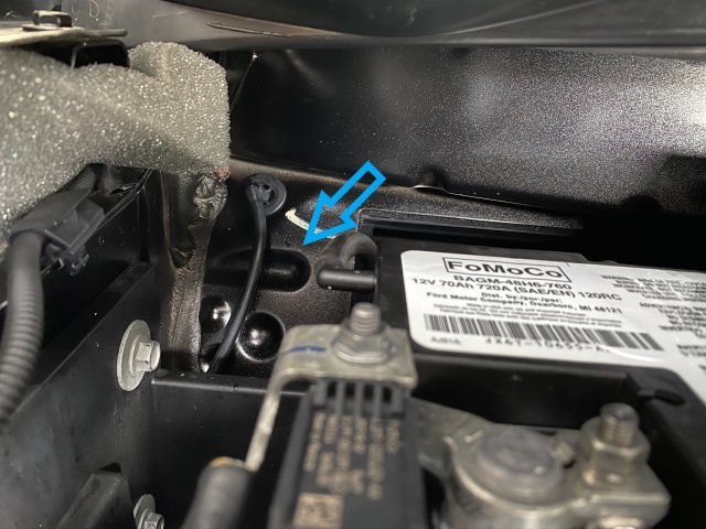

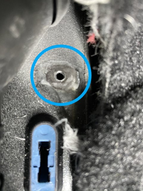

For me, this was the worst part of the entire install. The challenging part was drilling a hole in the firewall to get the power cable through. I couldn't find any easily accessible existing rubber grommets that I could poke the cable through. I probably spent a good hour or 2 just searching for an acceptable, existing place to pass the cable through without drilling. I even took the wheel liner off to see if any good spots were hiding behind it. Spoiler: there weren't. The truck is sealed up pretty well. So. Drilling it was. Which sounds super scary but wasn't that bad.
The location to drill is located behind the battery, next to the cabin air filter inlet. To get to it, you have to remove the clips on the passenger side cowl and sort of tilt it up so you can see what you are doing.
NOTE: do be careful here. The FSM says that once the fasteners are removed, the cowl should just come off - this is another one of those spots that is very vague. I say be careful because my cowl (maybe yours is different) was very, very stuck to the base of the windshield. Like it wasn't going anywhere. Maybe there's a trick to remove it, I don't know. What I do know, however, is that water sheeting off the windshield travels across the seam, onto the cowl, and directed towards the drain holes, keeping the battery (and your cabin air filter) nice and dry. If you remove the cowl, this seal has now been broken. Is it easy to put back? I have no idea. So I didn't try to remove it. Instead, I sort of held it up, used my drill with an extension to reach the firewall, and poked me a hole.
The hole goes where the BLUE ARROW is pointing. Again, use a brand new, sharp drill bit specifically for metal. Trust me on this.
Believe me when I say you are not spoiled for choice. The Explorer actually has two firewalls, the first is right behind the engine, but this is NOT the firewall that is right behind the dash. There's a cavity area where the battery is, fuse box, additional bracing, all kinds of stuff that make it pretty much impossible to get access to the firewall behind the dash. To the left of the battery is about the only clear spot - which is convenient I suppose considering that's where the power cable needs to connect. But you do not have a lot of room to work here.
I used my Ryobi drill and a Craftsman titanium nitride coated drill bit. I'm serious here. Do not use some old drill bit you have laying around. You will hate your life. Buy a brand new set if you have to. The set I used came with an extension (which you will need) - I started with a 1/8" hole and worked my way up in steps to the 3/8" bit. With those bits and the extension, my drill could just reach the firewall. You will see what I mean when you get access to this area and attempt to stick a drill in there. For what it's worth, this is drill bit set I used: CRAFTSMAN 21-Piece Assorted Titanium Nitride Coated Hss Twist Drill Bit Set at Lowes.com
To protect the power cable from sharp edges and to prevent leaks, I picked up a rubber grommet kit from Auto Zone - one of the grommets in there let the 8 gauge wire pass through, and the grommet fit tightly into a 3/8" hole.
I checked about a billion times to make sure there was nothing on the other side of the firewall that would get damaged if I drilled here - don't take my word for it, you should check, too. But if you use the same spot I did, you will be fine. Any other spot...and you better do a good job of checking. It is really tight up in the dash back there with the blower motor where it is.
