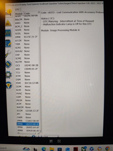

I have a Ford Explorer ST model 2022 with a brake system malfunction. I bought several ABS units from eBay, but they all received the same error code, C0049:01, and also displayed error U0418. The number of accidents involving these units was relatively small. I tried several methods to fix these errors, but to no avail. I even drained the brake fluid using software, but the result was the same. Does anyone have any information to help?

Probably not ABS module problem. Did you replace anything else? That first code is low brake fluid--maybe the sensor is faulty. The 2nd? maybe check all your ABS sensors at the wheels.
