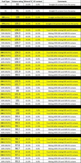

My apologies, I didn't see the DIY Ethanol Sensor listed in mycbtech's mods. If your concerns are a reduction in overall octane, then please see below:
Check out the attached file to see calculated octane values for Ethanol blends with premium.
The chart shows a true 50% E mixture with 91 octane pump gas having, effectively a rating of 101 octane.
This .GOV link shows Ethanol having an octane rating of 109.
Selecting the Right Octane Fuel (fueleconomy.gov)
Using an online fuel blend calculator and using the values for E listed above and then 87 for the gasoline I get a rating of 98 octane for a 87 based 50% E blend. That assuming that the 87 octane fuel didn't have Ethanol in it (which it almost always does) so the overall value will be slightly lower.

thanks for the Reply. for all intents and purposes it looks like it would end up being the same mix you would just need more E85. I was able to get the blend I wanted from using 87 over 91 and honestly, it didnt save me that much money lol. blending to get e50 on an empty tank takes about 6 gallons of 87 so I saved around $2.40 when all was said and done.
