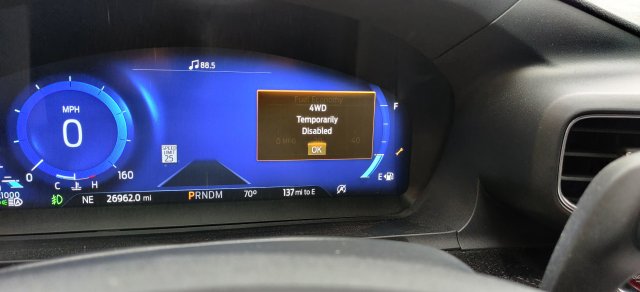

4wd temporarily disabled
2022 ford explorer st
Nope. That was the cause!
Hey sorry to bother again but do you happen to have the part number for the sensor ?

If it was the Front Half Shaft Speed Sensor the part number is HL3Z-7H103-D. This is a common problem with the Explorers. There is a TSB out on it: 20-2071.
