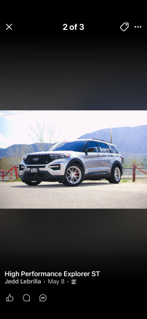

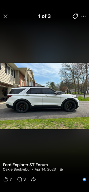

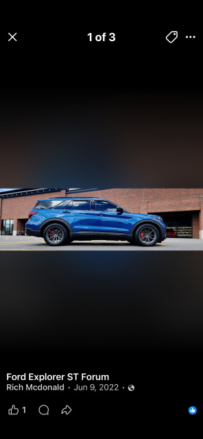

thinking about this setup
michelin tires pilot SUV
20x10.5 +30 ( i think +30 makes it flush ?? )
295/40r20
3,069
1,360
295/40r20
Yes, that’s the golden setup for these vehicles. A 295/40r20 is too short though, would look a bit wonky. 295/45 is what you’d want.

Looking for pictures if anyone has this setup too..

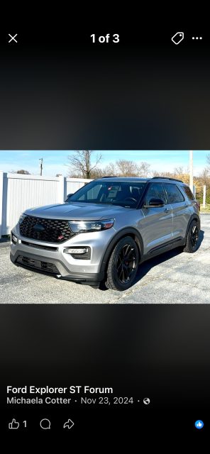

Sorry guys still kinda new, would you guys think these wheels would be able to do the same size yall talking about?
3,069
1,360
No, the stock wheels are only 8.5” wide, so the widest tires you could run would be a 275/50r20.
