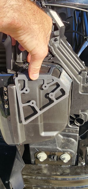

So first mistake on the Explorer so far, removed the shutters after installing the intercooler (same process I did when I installed my COBB intercooler on my truck) now the CEL is stuck on for "Active Grille Shutter "A" Position".
Doesn't bother me as I know what it's for, but I guess once tuning is available that will be next on the list. I should have done some more research before I tackled it in hindsight.

Yeah you’re supposed to just pop off the shutters and keep the assembly. Not really any extra flow benefit, so I’m curious as to why you did this?
That is what I did, just the shutters removed. Slide bracket and motors are still installed/connected.
I followed the same process as my F150. That requires the entire shutter assembly to be removed and cut out, then you relocate the motors but keep them plugged in.
Other than having to take the front end back apart, I still have all the parts to reinstall if needed.

That’s odd. I’m wondering how you’re getting a code then.

I plan on taking it apart again in the future to add a better mounting bracket for the big mouth. So I will take a look and see what's going on.
