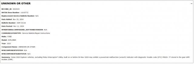

The TSB is from Nov 25 2024 and says any explorer manufactured before Nov 4th 2024 could have this issue. Mine was built October 19th 2024

Totally agree! Now that I've seen the TSB, the cold theory doesn't work. My build date was 11/21/24, right after it was issued.

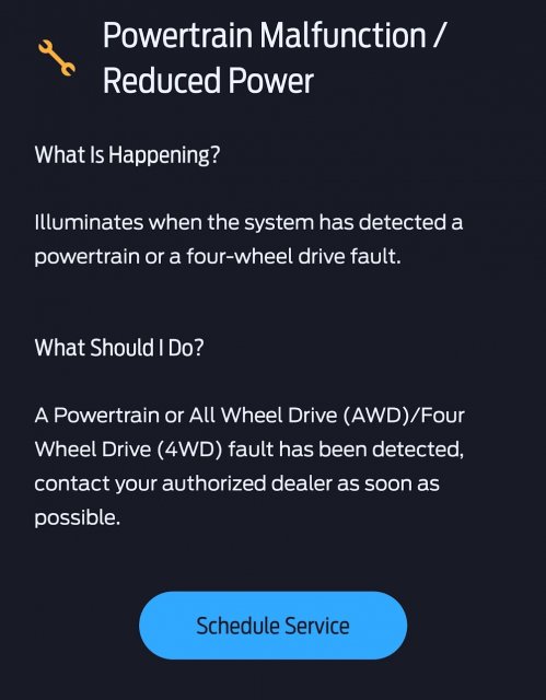

Yes If I login to the ford website it says "Action is Required" but has no other information.
But on the Android App it is displaying as I posted above, the "Powertrain Malfunction/ Reduced Power"
Also the yellow wrench is on my dash and displays the same powertrain malfunction message.
On my drive to the dealership the light went out. When I got there they informed me they need the car for the whole day and there was no courtesy cars for 3 weeks... Why didn't they mention that when I booked the appointment, these guys are nuts...
It's still showing the yellow wrench on my app and "service reminder" online...
Absolutely terrible customer service experience so far from Ford, I'm now actually deplored, lol.

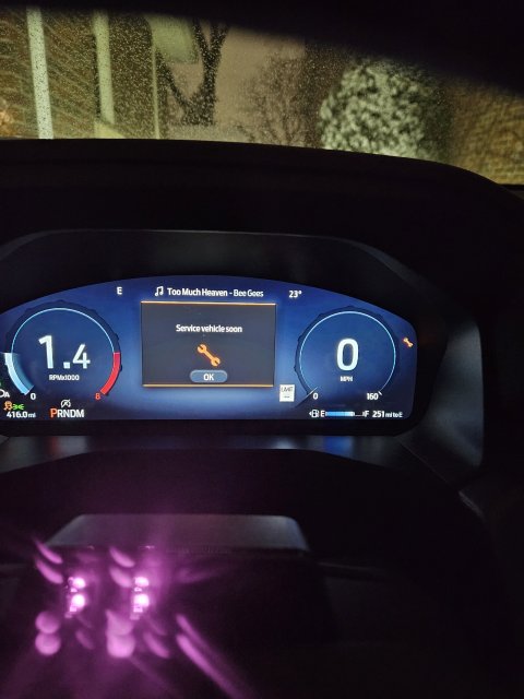

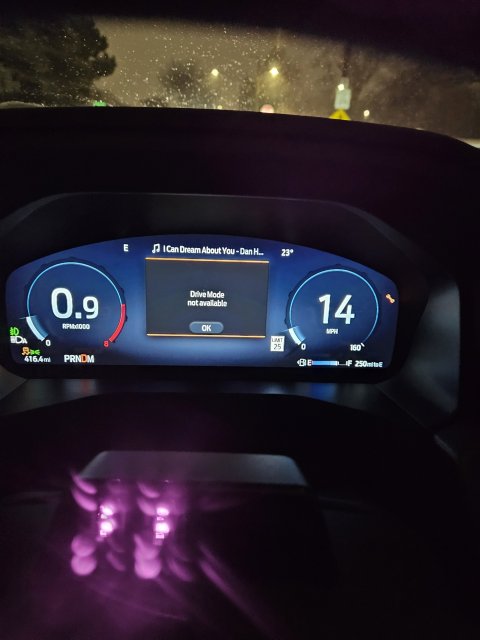

Looks like your Explorer didn't like your music choice either!!!! (Just joking!) I'm sorry you have to deal with that issue.
Ha ha! Yes, all of this happening while the Bee Gee's harmonize in the background! :ROFLMAO: Started it up for the drive home a few hours later and no wrench, drive modes worked perfectly. I finally have the message in FordPass so at least I have evidence this time.
