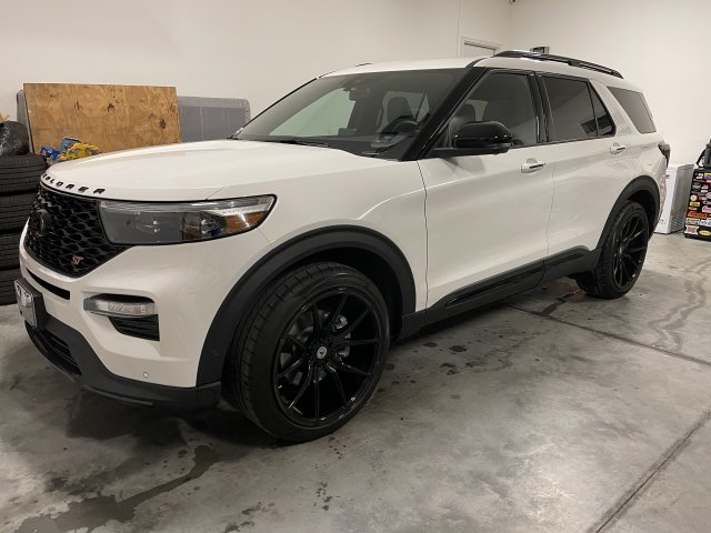

Start with picking a wheel width...then you can figure offset from there for how you want the wheel to fit the car...further in or out. For OD stay at 30.7” max.
I run a 30.4” tall 305/35 on a 22x10.5 at +30 offset. This is as far as you can push a wheel out and be flush with the fender...and it’s IMHO the perfect fit for these especially with a drop. 4CC94EC3-0343-460E-8CC8-C64EFCFD9424.jpeg

Your car and wheels are so nice!! Love it!!

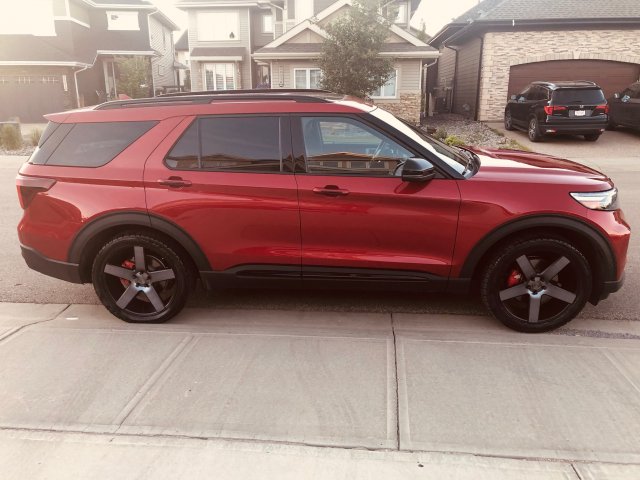

22 inch dub ballers. Got tired of looking for 21s and found a much wider selection of 22s, so I put winter tires on the stock 21 inch rims, sold the tires and used that to offset this new wheel and tire combo (approx 3500 cdn so say 2800 US or so?). Good luck with your search it’s a lot of fun. F4C2E8F0-8B53-4EA6-B2AC-42C30266C12F.jpeg
