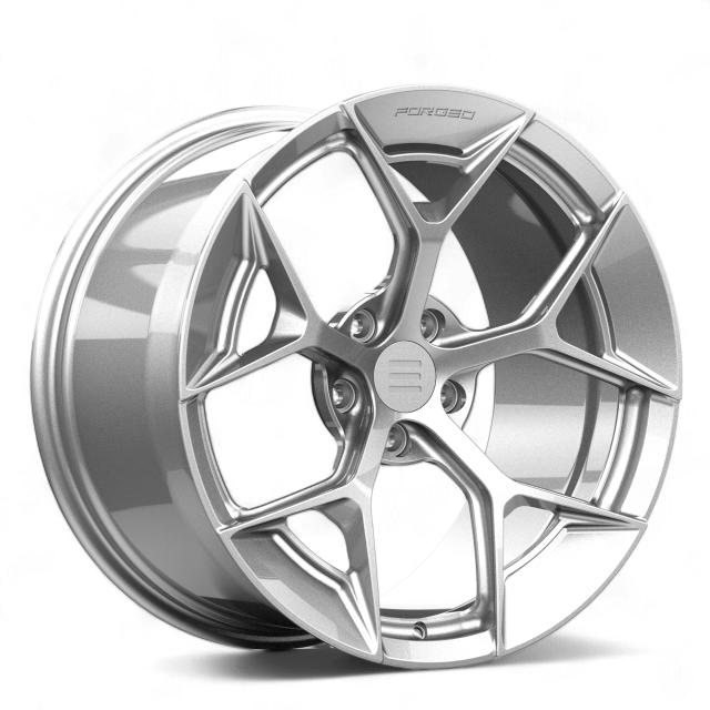

Found these and I can choose a single color as well, was thinking gunmetal.
Those look awesome, what wheel is that?

EKW wheel, found them last night while looking for wheels. They make GTD clone wheels, still have to reach out and make sure the bore is what I need.
Mustangs run the same 70.5-mm hub bore, even if its bigger you can run hub centric rings.

They emailed that they will machine the bore I need.
