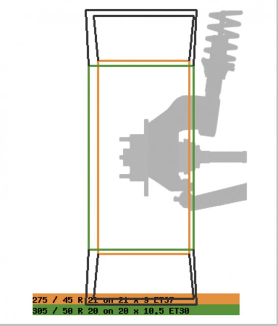

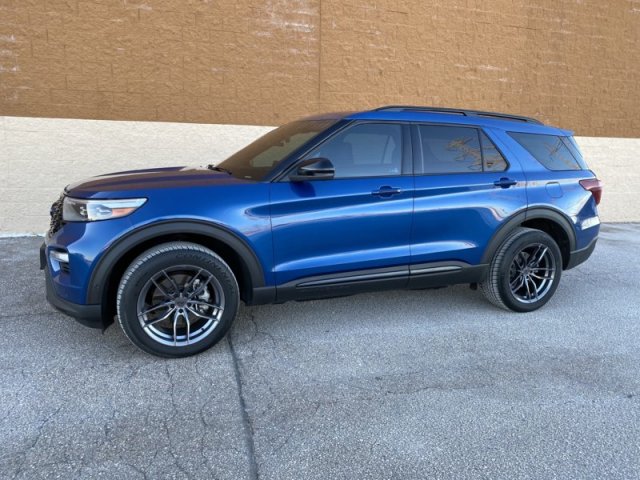

What do you guys think? This is in comparison with the stock 21”s

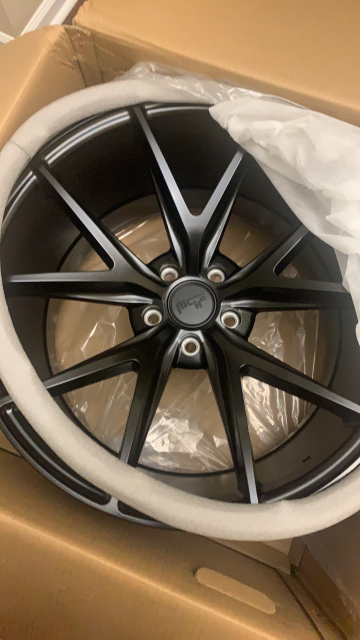

I purchased Niche Misano M117 20x10.5 +30. It’s my wife’s car so I didn’t really worry anything about performance specs (weight). As far as I know 285/50r20 will clear.
Another option I’m willing to look at is:
Stock 21s diameter: 30.7
305/45/r20: 30.8

A little info compared to the stock diameter (30.7”) these measurements will be the closest to stock ride height while also being able to clear
I have seen somewhere that anything about 32” will not clear so here it goes.
305/45r20: 30.8”
Unfortunately there are close to zero tires made for this size
305/40r20: 29.6”
- Pirelli, Michelin, Bridgestone, Continental
295/50r20: 31.6”
-General Tires
295/45r20: 30.5”
-Pirelli, Nitto, Toyo, Michelin, Falken, General, Continental, Hankook, Sumitomo, Yokohama

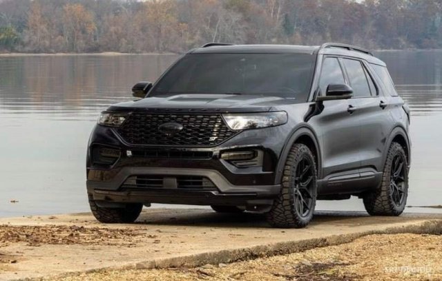

Photo by: JoshuEvans of ExplorerForums
285/50r20: 31.2”
- Good Year, Pirelli, Nitto, Hancook, Kumho, Yokohama, Cooper

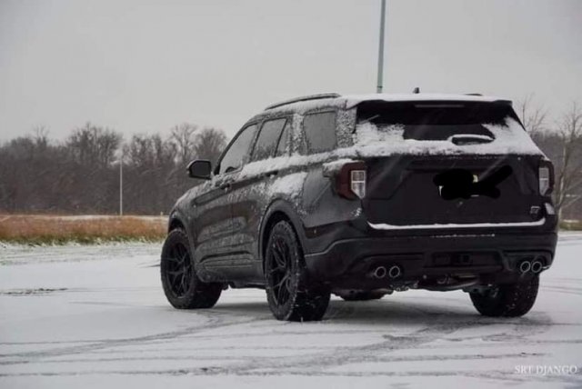

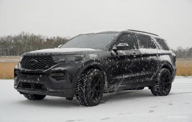

Photo by: @srt_django (Instagram)

Any idea what kind of wheels those are on the Black ST (last pics)??
92onward
92onward
Active Duty U.S. Navy
79
79
VOSSEN HF5

Does anyone know what size / kind of tires are on that black one. Diggin the look...
