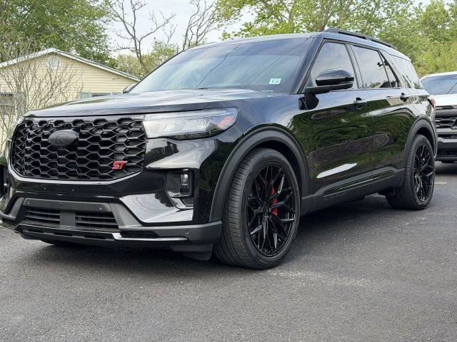

2026 Black ST Build
Ifixstuff
New Jersey
2026 Explorer ST
Black ST’s are a dime a dozen, but I love the look.
I decided to do the usual.
Intercooler
Downpipes
Charge pipes with blow off.
3” thermal exhaust
Rear diff awr support
12.9 rear diff bolt and insert
93 tune
Rear sway bar
Lowering springs
Adjustable end links
FenFab emblems.
Stuff I haven’t seen much of.
Big Brake Kit
Steering wheel replacement.
Items still on the way.
22x10.5 forged wheels.
Fen Fab intake.
Zeus Hitch cover.
Tires I’m not sure about 315/35/22 or 305/40/22?
