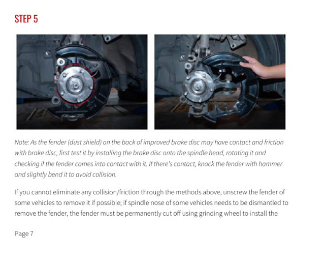

Has anyone installed the Superforged break kit on their 2025 ST here? If so, do you know if this step regarding the Dust shield is necessary for installation on the 25 Explorer ST? Is there any cutting or trimming involved?
2,056
1,436
IIRC I just bent mine with my hand until there was no contact. This was on a 2022.
