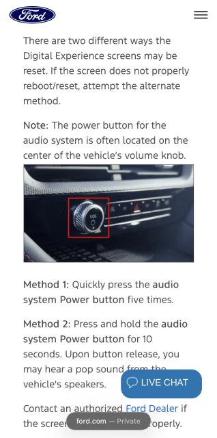

There are two options for soft reset, shown below from Ford.

The 2025 doesn't have a physical fast forward button.
I'll try the other methods above the next time it happens. I tried these before but maybe I was doing something wrong.

When I first got my '25 the process was hold the power for a while. But after an OTA update last year, that no longer works, but the press the power button multiple times fast is the way since that change.
