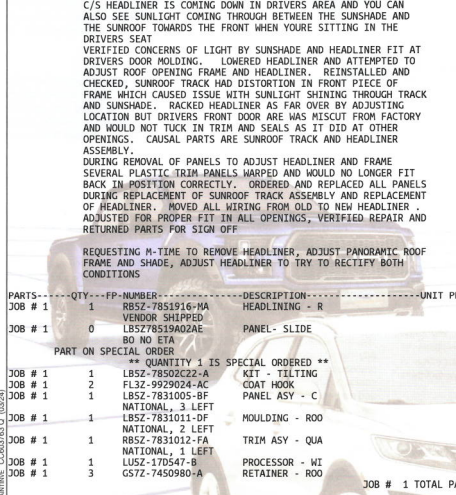

After two weeks in the shop, picked it up today. They replaced the headliner and the sunroof track. No more gaps over the driver's door nor when closing the sunshade.
They also replaced the left front strut for a clunking noise in addition to shimming a rear trim panel due to it rattling bad.

work order:
