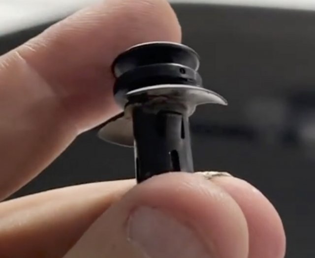

Planning on wrapping my roof along with the C-Pillars, and it looks like I'll need to remove the roof rails to get the job done correctly.
I believe there is a plastic retainer that is considered single-use that I'll need to replace.
I've searched the ford parts catalogs and cannot locate it.
See the attached pic of the plastic retainer pulled from this video (not me) at around 11:30 min.
If anyone knows what that part number is I would be grateful

You don’t have to take that piece off at all. Just drop the headliner and remove the nuts off the studs that are built into the rails and front retainers.
