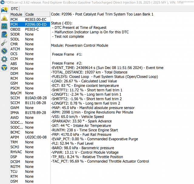

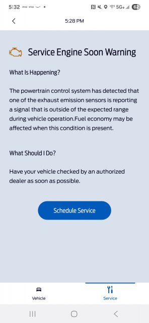

I recently installed CVFab downpipes, and everything seemed fine until I pushed the car harder. At that point, I received a "power control system" error indicating abnormal emission levels. I half-expected this, but I was able to clear the code using Forescan.

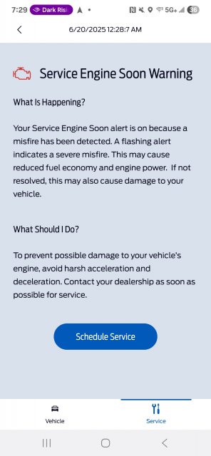

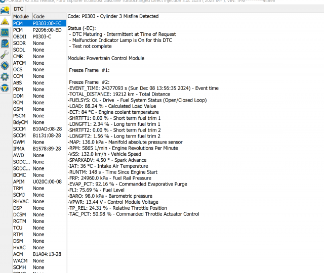

What happened next is what I don't fully understand and could use some help with. After clearing the error, I went back out to drive it again to see if the emission issue was a one-time occurrence. When I pushed it and hit the rev limiter, the car immediately lost all power and started misfiring, and the check engine light flashed. I eased off the throttle and limped along for about 30 to 60 seconds, and then the car corrected itself and stopped misfiring. I got another error message in the Ford app saying I had a severe misfire. I am attaching the Ford app errors and the two PCM Forescan messages about a misfire on cylinder 3.
Has anyone seen this or have any idea how to solve it? If not I'm going back to the stock downpipes...
