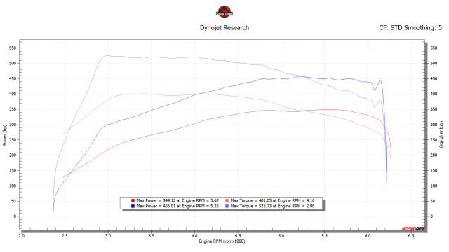

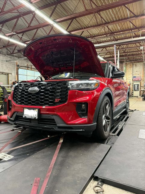

Tuned a 2025 ST on the dyno today! I tune at least 5-7 of the new trucks a week, mostly road tuning. This one was on the dyno!
Super basic mod list:
93e10
Fenfab Intake
CVF Intercooler + piping
Thermal Catback

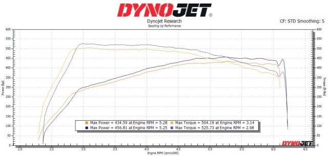

Stock these make 330-340whp. I will work on getting the stock baseline asap
456whp 525wtq
I capped torque there because I don't want to make more without catted downpipes. Once this car gets downpipes we can add another 20 to 25hp!
