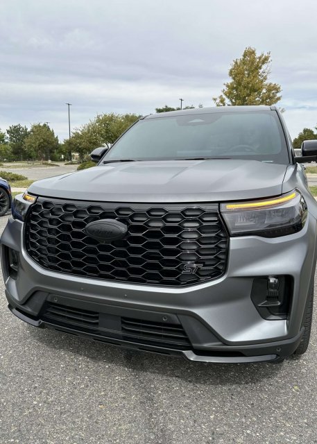

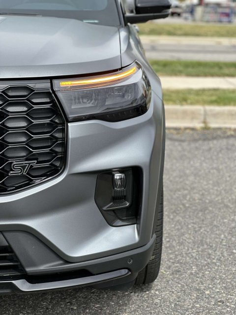

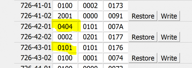

I was able to turn on Amber DRLs with my 25 ST, but I was only able to get it to work through the (As Built) BdyCM Config, I couldn't find the option for the "Right/Left Front Turn Lamp Usage" in the BdyCM.
I used the Livnitup - 2025 Explorer Spreadsheet with Forscan to find the correct setting, but the interior sound for the turn indicators no longer works once enabled.
(Maybe it will magically come back after a few power cycles?)
Previously with my 22ST, I was able to use just the BdyCM and I didn't lose any sound.
Does anyone have any ideas to enable the sound and keep the Amber DRLs?
Sound came back after a day. No issues with those 2 changes.
Changed 726-43-01 from [x2x2-xxxx-xx--] to [x1x1-xxxx-xx--].
I also changed the "Using DRL with Turn signal" from Inhibited to Allowed in the BdyCM config.

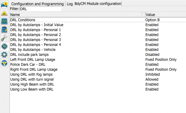

I did and have been through this over and over. I have to think I'm just missing something. Here are the changes I made to the "as built" config and here are the current DRL setting for the readable BdyCM.

Hmm
I would put your vehicle back to as built on all files you changed
Do several key on, then off cycles
Then retry.
Load your changes
If it fails agsin..we need to reach out to livinitup
powerboatr
718
470
Just to check we are on same page
Your headlight switch is in auto
It's daylight out, and vehicle is in drive.
So..for my sanity
You have dr8ver in drivers seat. Foot on brake, vehicle in drive, switch in auto, and it's light outside.
Those values are correct

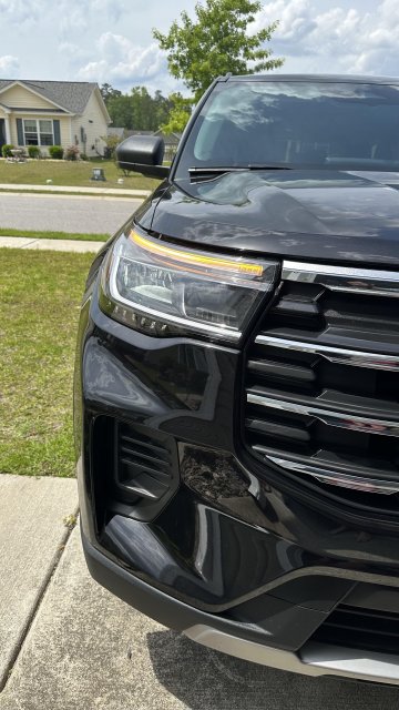

Looking for some help here. I just picked up a 25 Explorer Active and looking for some advice on the amber DRLs. On the active, the default drl is the low beam. I have edited the bcm asbuilt to get the amber bars illuminated but the low beam stays on. I have looked through the forscan spreadsheet and don't see anything that stands out that would turn off the low beam. Any ideas?
