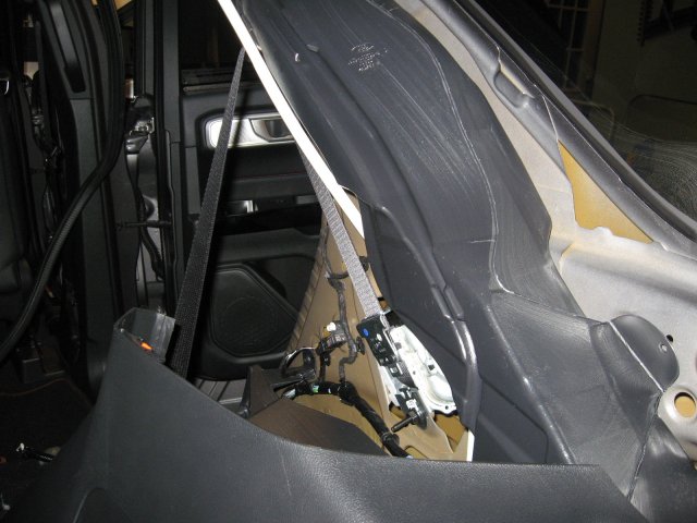

Update:
The sound that I was hearing was coming from the passenger side C-pillar panel where it covers the headliner ( it made noise when I presses at a certain location), puled the panels and found the passenger side roof opening panel rear drain hose routing out of place and was chafing against the headliner, also found a piece of plastic behind another panel, (I was also occasionally hearing a crunchy plastic sound) . Will reroute the hose in the channel provided for it.
