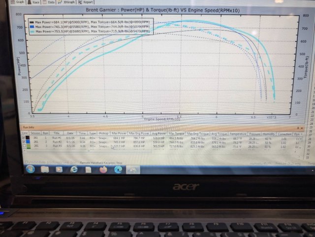

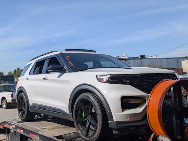

Well, got Brent on the dyno today all the way out in Alaska!!
This is what he calls Stage Eleventeen, lol!
The whoosh turbos did work today!
He needs to get out and track it so we can see how it does, it's definitely spicy! Just wanted to show you all
753whp 715wtq
Fuel: E50
Mods:
[Stock Motor]
CV intercooler
Fenfab cold side charge pipe
Fenfab hot side charge pipe with turbo smart BOV (race port)
Fenfab oil pan
Fenfab toe links
Fenfab vertical links
Fenfab prototype rear Sub frame bushing limiter
Fenfab transmission mount insert
Fenfab down pipes
H&R lowering springs
Fenfab ethanol sensor kit with Fuel it sensor
Thermal 3"exhaust
Velgen light weight 22" wheels
305 series tire (lion heart)
Category 2 transmission build, Raybestos GPZ clutches with extended E clutch
Stock valve body and torque converter
Nostrum stage 3 injectors
Nostrum HPFP ( bought before Goliath was a thing)
Woosh stage "X" turbos 46/58 compressor, 50mm 9 blade turbine wheel
ID speed rear differential brace
NGK plugs- iridium
Super forged BBK
