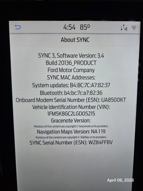

If Carplay freezes, then yeah, could be the dongle. They are not all the same. But check to see if you have Sync 3 version 23188. That is the final version. Previous versions were bug ridden.

Also, this is the version I have, and when I checked the latest software it can't back saying that I had the latest update. How can I get version 23188?

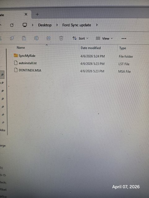

So, I tried the battery being disconnected for 30 minutes, and I still could not do a master reset. I also tried to do the upgrade via USB, and when I inserted the flashdrive, I saw that it was read, but nothing happenend and the upgrade didn't automatically start. I double checked that I had the right files, also the correct flashdrive (exFAT formatted), and nothing. Any ideas, friends?

One other thing, did you unzip the folder after you did the download?
If so can you post a picture of the files you have?
