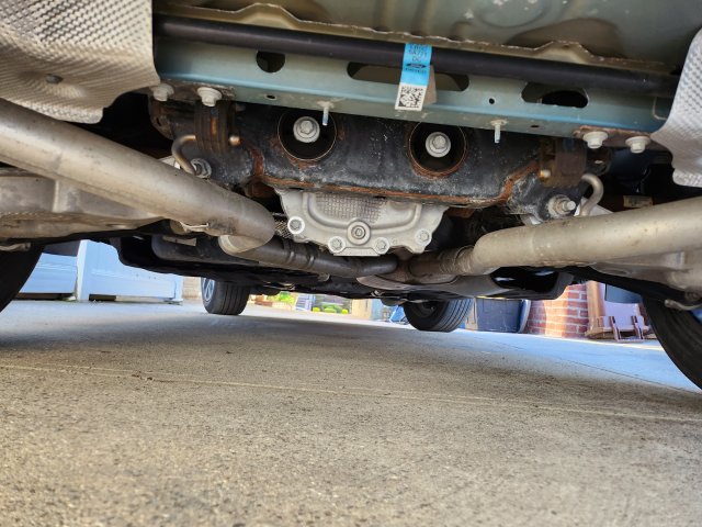

So mine is an OG 2020 which I purchased in Jan of that year, has 26k New York City miles. It's been through a few winters, and obviously salted roads. I try to give it an underbody wash via the drive-through wash whenever it goes through salt or every so-often. But I just looked at mine recently and seems like its got a decent amount of rust for a 3 year old/30k mile car.. Anyone else got the same? Seems like poor coating/protection on Ford's part, I can feel the paint flaking off on those rusted areas, granted its only surface rust for now. Give it a few more years un-treated like this and I'm sure the rust could get worse to the point of causing issues. Guessing it'd be best to sand it down somewhat and re-coat it?

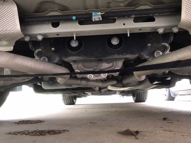

Here's mine, it does look like you have some rust. Sand, polish, and paint sound like a good project. Could that be covered under any type of warranty?

Do you park it outside all the time?

Yup, its been parked outside all its life. Thinking about cleaning it and spraying POR-15 on it.

Looks way better than mine for sure.

That's the subframe with all that rust

20 minutes and a little #0000 steel wool and a quality rattle can paint in matte black or semi-gloss will keep that piece looking good for a very long time. I quite like Krylon but Duplicolor and others will fit the bill equally well. Touch it up as needed. Left unattended it will likely get pretty rusty.

Good tip, will try that
