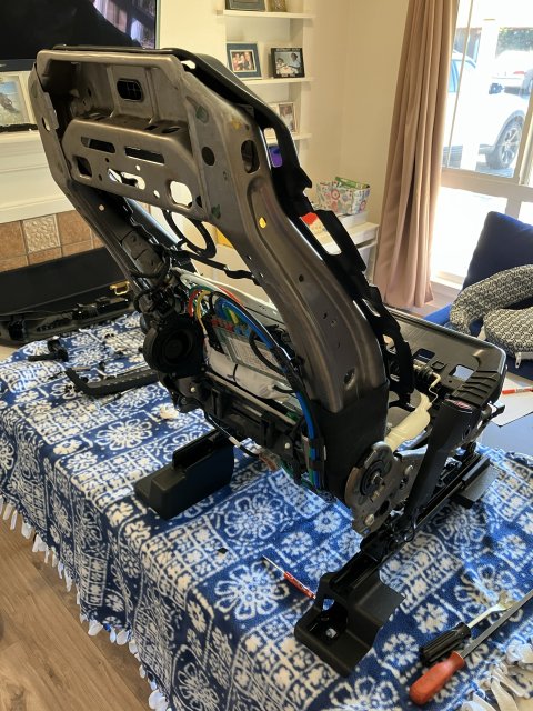

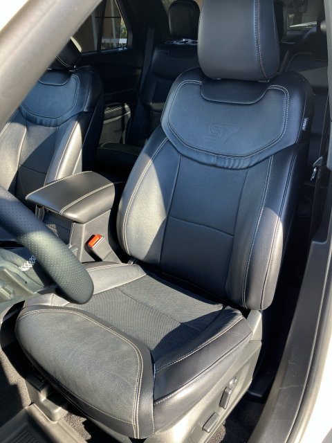

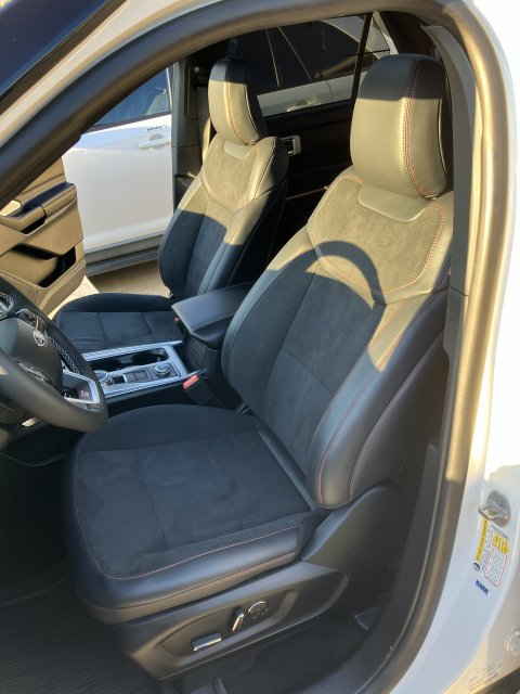

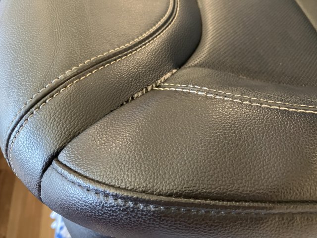

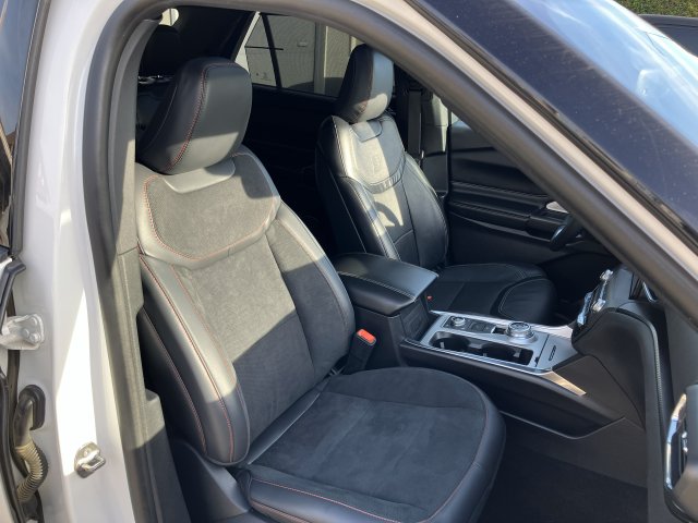

I just picked up a 2020 and a week later the drivers seat ripped, of course I discovered this was common. While looking for a new seat cover I scored some take off 2025 covers for next to nothing. I was sorta rolling the dice because the 2020 seats are different from the 21+. They do fit, while I was changing the covers I also fixed the broken wires to the lower seat heater temp sensor which was broken on both seats causing the heaters to be inop. The lower foam is a bit different, when the seat heater fails again I'll be changing the lower foams out on both seats. I'll likely be swapping out the door panels and console lid at some point but I'll give the kids some time to mess up the originals first.

I'm very planted in the seat now, no sliding and the seat feels overall more solid (not that it is). My Edge also has Alcantara inserts and it stops all the sliding vs regular leather.
How long did it take you?
First one took a couple hours but that was also due to running tests to determine why the seat heaters weren't working, the second one was a little over an hour.
