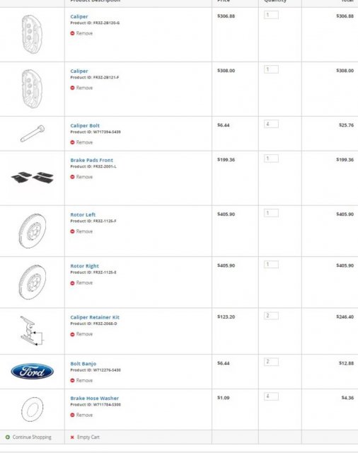

Hello, I have a 2021 Ford Explorer ST and I want to put the GT350 calipers/brakes on it or some that you recommend, which is best? And where can I buy those brakes?
I have seen this
https://lmr.com/item/LRS-2120RK/shelby-gt350r-brake-caliper-kit-15-17
What I need to do the upgrade from my calipers to the BREMBO one
You can’t use that kit for the ST. The rear calipers won’t work and you need extra components for the fronts to work. You need to piece together it on your own. Here the full list (you will also need the caliper adapter brackets from Tony Hernandez on Facebook and if you have stock 21s you need a 3/4 IN or bigger spacer

Here my parts list.
Never did the swap.
Part #
FR3Z-1125-E RH-Front Rotor
FR3Z-1125-F LH-Front Rotor
FR3V-2010-BE LOADED CALIPER, FRONT RIGHT
FR3Z-2B120-G
FR3V-2011-BE LOADED CALIPER, FRONT LEFT
FR3Z-2B121-F
FR3Z-2001-L Brake Pads Front
FR3Z-2068-D Caliper Retainer Kit
W712276-S430 Bolt Banjo (x2)
W711784-S300 Brake Hose Washer (x4)
W717394-S439 Caliper Bolt (x4)
GT350 Adapter Brackets - DM Tony Hernandez
