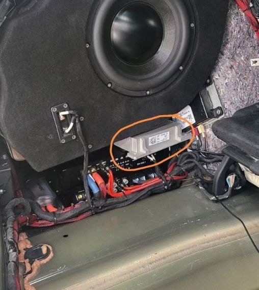

Good day evryone Sorry for my English)) Can you tell me how to extract a clean signal from the head unit (optical or coaxial). I did my best to soundproof the explorer) I have a signal using the Bluetooth AptX HD protocol, but I wanted to remove the signal from the head unit without a standard amplifier. I had to take the signal after the standard amplifier, then I connected the D class processor amplifier for 8 channels and then everything else. How to get rid of the standard amplifier in this circuit?In our country, the explorer 2020 has not yet been studied)))

If you mean you want to eliminate to oem
processing completely and use optical into your dsp/amp then the Nav TV Zen A2B is your best bet.

Thank you! Yes, this is really a great option. it collects the signal in a heap after the head unit and distributes it into 6 or 12 channels to connect to the processor, right? and regular amplifier I can throw away))? did I understand correctly? and yet it is a pity that there is no optical or RCA outputs from the head. Now this is the biggest task - getting a clean signal from the head units of modern cars..

The A2B completely eliminates the oem amp and all of its processing. You’ll have a digital signal from the HU to your DSP.
