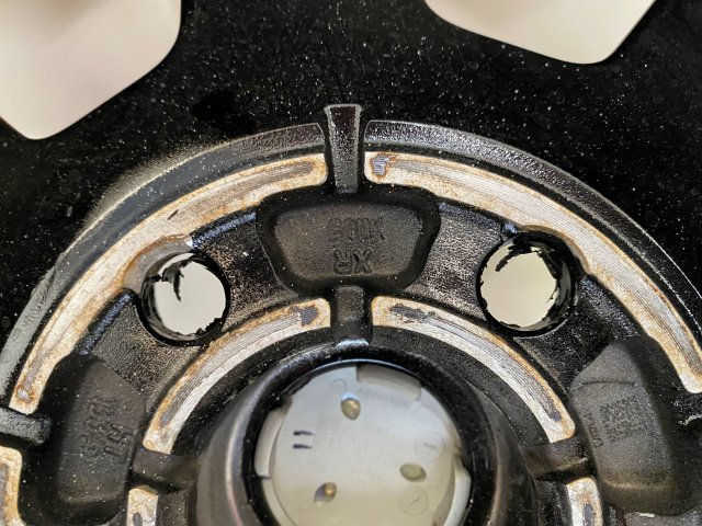

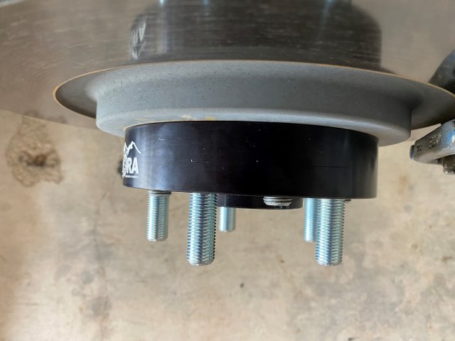

FYI, here are pictures of how much of the stock stud sticks out from the 1.25 and the savior of a cutout on the back of the rim so you don't have to trim the studs for 1.25's.
