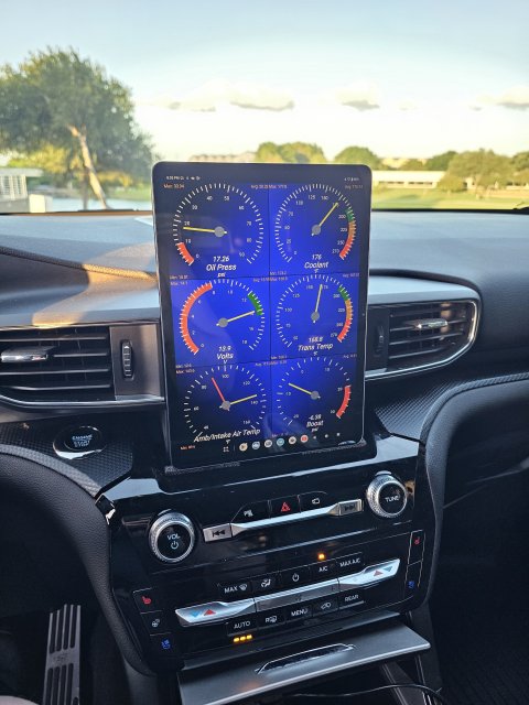

Postscript - not having an oil pressure (or other truly useful PIDs) gauge on these Explorer's is a HUGE miss by Ford and a pet peeve of mine. P3 is supposed to be working to add oil pressure to their gauge for us.
296
157
Farmers Branch, TX
I wish that was possible, but it's not. The only way to view a log file yourself with the RTD/TDN setup is to download HPT's VCM Suite on a laptop, plug your RTD into a laptop, download the log and view it there.
I was thinking more like using a BT OBD adapter and an app.
