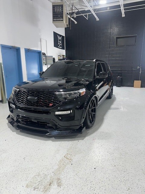

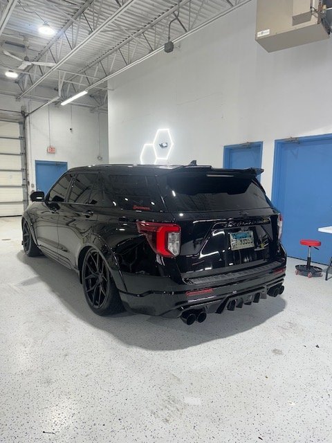

Welcome to my build !
2022 Explorer St
Engine
- Whipple Intercooler
- Velossa Tech Big Mouth Ram intake Snorkel
- AFE Intake
- Fenfab Cold side Charge Pipe w/ HKS BOV
- Fenfab Hotside Charge Pipes
- Fenfab Downpipes
- Fenfab ECU Cover
- E50 ZFG Tune
- Thermal 3 Inch
Suspension
- FV Suspension Air Ride With Air Lift Management
- Steeda Front & Rear Adjustable Sway Bars
- Steeda Rear Adjustable Toe Links
- Speedlogix Rear Vert Links
- Fenfab Driffty Stiffy Brace
Interior & Exterior
- 5% All the Way Around + 30% On Windshield
- Custom Forged Carbon Wheel
- Black Emblems ( Emblem city )
- P3 Vent Gauge
- Roof Rail Delete
- SS Tuning Front Lip
- SS Tuning Fender Flares
-SS Tuning Top Spoiler
- SS Tuning Hitch Insert
Wheels & Tires
- Rohana RFX5 ( 22X10.5 +40ET )
- Toyo Proxes ST III ( 295/35/22 )
- 1 Inch Bora Spacers
https://www.tiktok.com/@tuners
Please check me out on social media
Instagram - @Automovil
Tik - Tok - @Tuners
