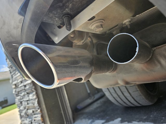

I have been searching and it seems everyone welds new tips on the exhaust of the ST's. Dumb question but could you not just cut the pipe behind the existing fake tips and use a 2.25 clamp on exhaust tip? Is there not enough room or something? I dont see the need for welding the tips is this is possible or am i missing something obvious?

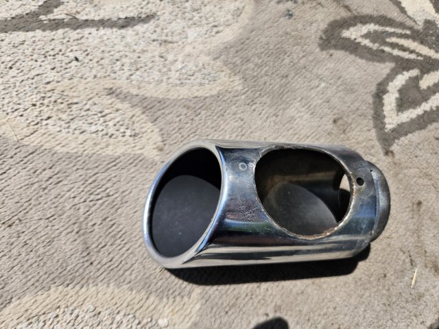

While waiting for my factory exhaust to fail or I’ve had enough of the stock flex pipes, I did this maneuver. Some may say hack job, but it’s cooler than the stupid fake tips. The exhaust does come out the back. Carbon fiber slip on trick.

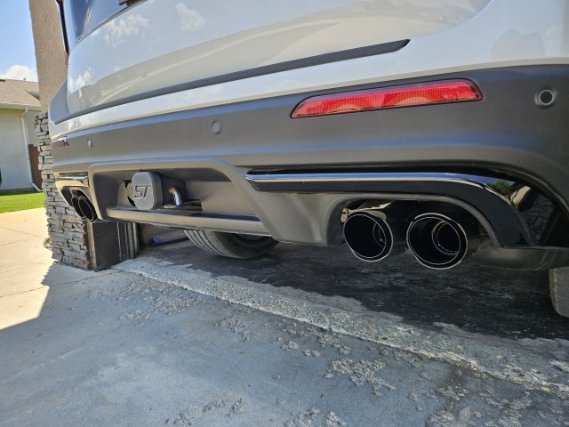

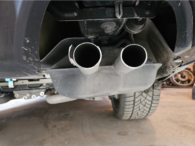

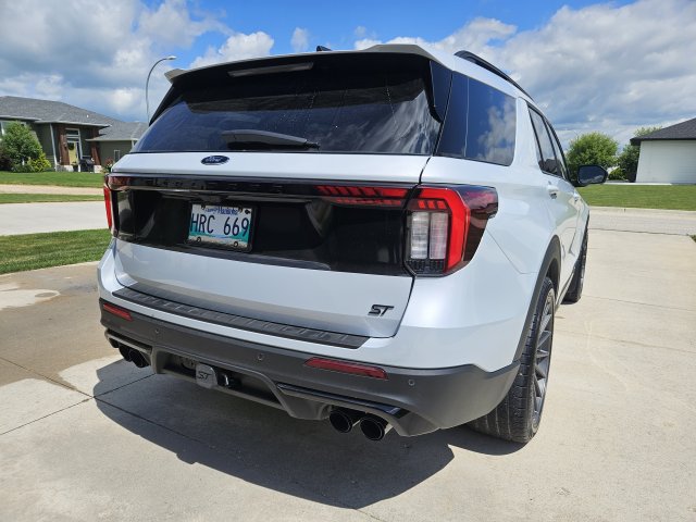

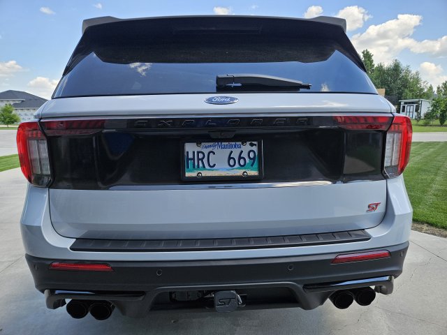

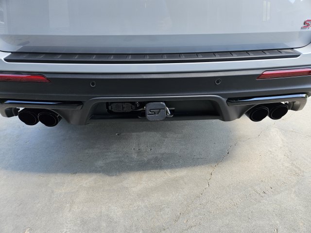

Clamp works just fine on mine 20260708_133049.jpg 20260708_142543.jpg 20260708_130745.jpg 20260708_133011.jpg

those are the exact ones i ordered, thank you.

Cut off right at the edge of the weld where the factory tips are joined otherwise you spend ages trying to grind the weld off to make the tip fit nice and flush, this I know lol
