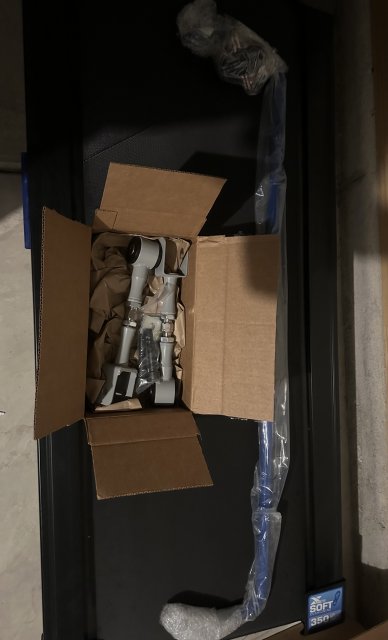

Heading to Florida next week. Might order power pack and see if they will install while I am there. If I cant make that work, ordering thermal exhaust next.
377
127
Desert South West
I had to drop the exhaust to install the rear sway bar, I found it easier to install rear springs with the exhaust, rear sway bar, and rear rotors removed. So I just did everything at the same time, springs, exhaust, sway bars. Was easier to do the front sway bar with the front shocks and front rotors removed, and one old sway bar bracket removed.
