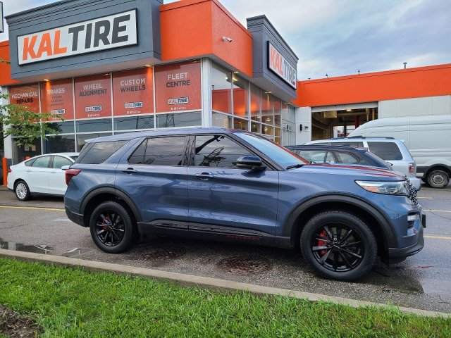

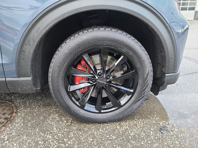

Toronto, ON, Canada
I got these for mine. Ruffino Wheels - Reactor - Gloss Black - 19", 5x114.3 and Nokian Hakkapeliitta HKR3SUV - 255/55R19.
