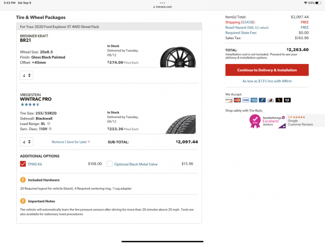

Would these work? I’m a bit confused because when I try to shop winter tire and wheel packages it says (Tire Rack and others) that there’s nothing available, but somehow when I shop them “manually” it seems to say that they are compatible. IMG_0170.png

Just to be sure that you have the Street Pack, I would look at the rear rotors and make sure they are vented rotors like the front. Anyone can put those wheels on and paint the calipers red. Either way, I would say that any 20" wheel that fits the standard ST should also fit the ST with the Street Pack brakes.

Thanks. Are you certain that’s true that any wheel that fits standard would fit street pack? If so, why do the dealers’ website have plenty of options for standard but none for street pack?

As long as you do a search on Tirerack with Explorer ST with street pack, they will guarantee fitment.
I would call to be sure before ordering online from any wheel place. I did run a quick check on Tirerack and for a 20" wheel there are 127 wheels available whether I chose standard ST or with Street Pack.

Would these work? I’m a bit confused because when I try to shop winter tire and wheel packages it says (Tire Rack and others) that there’s nothing available, but somehow when I shop them “manually” it seems to say that they are compatible. View attachment 19515
Our site [and the others] use vehicle data to compile tire and wheel packages that meet all the specs of your vehicle. For instance, when I was shopping for 18x8 wheels, TR's tire results were "no results", and that's because none of the tires that would fit had a speed rating equal to the stock max speed the ST's can go. Therefore, "no results". It can be frustrating, but also, why would a tire that is rated for 118mph be sold to go on a vehicle that can go 140mph? When you use the tire and wheel package function, it's looking for wheels that are 1:1. Once you start manually entering in sizes it opens up to wheels with different offsets, require spacers. new lug hardware, etc.
