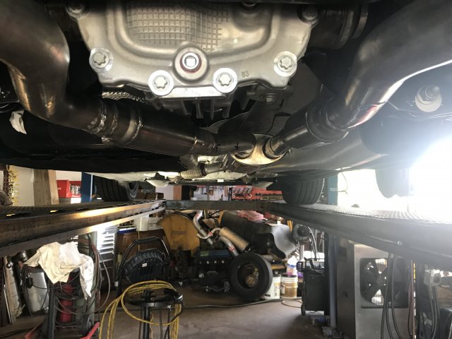

Yes. I added some small Borla resonators. Made the car a joy to drive all the time. Still has a great sound but a tad quieter. Jm F3F52CBA-943F-4D70-B641-22EC98EFD3AB.jpeg F3F52CBA-943F-4D70-B641-22EC98EFD3AB.jpeg

If Borla would have sold the mufflers seperately with the black tips or even sold the black tips seperately I would have done that. I did research for months to find a tip I liked but wasn't finding what I wanted which was the Borla look with an acceptable exhaust tone. I like the way the Borla S-type sounds on start-up however it is a bit loud for me on acceleration.

Trust me it doesn’t sound like a Singer sewing machine like stock does. Still has a nice rumble at idle and a nice bark when you got your foot in it. 100% better sounding and looking! Jim

So Borla updated their website over the past few months. There used to be a 2.25" straight through resonator starting with a 6 series part number. Now they are listing crate mufflers. Do you remember the part number for the resonators? I assume they were the 2.25" in/out?

Finally found what I was looking for. You had previously posted Borla #400937 resonators. Just ordered a pair from Summit.

So anyway I started this post. I had ordered the resonators to add to my Borla S-type system and then got to the local Midas and they didn't have a tig welder so I shipped them back. I was also afraid they would dick something up installing the resonators. My Borla S-type continues to burn-in as today I heard the gurgle-pop in the exhaust as I was slowing down from 30 mph approaching a traffic light in Normal mode. I do not mind the tone of the Borla S-type system now.
