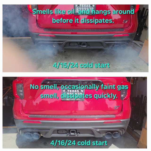

Cwolf747
Fort Worth, TX, USA
Did you smoke every cpld start or intermittently? Sometimes it's lots of smoke,smells like oil, and the smoke hangs around. Other times it's clearly just condensation, with the occasional faint fuel smell. Of course this never happens when it's at the dealer. Smh.

^ Your problem is that it only happens on cold start. There in your own pictures some form of smoke happens 2 days in a row.
Take it to the dealer, drop it off overnight, be there for initial startup in the morning.
I wish you the best of luck with that.
