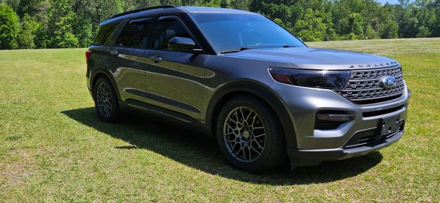

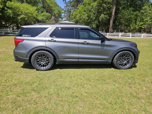

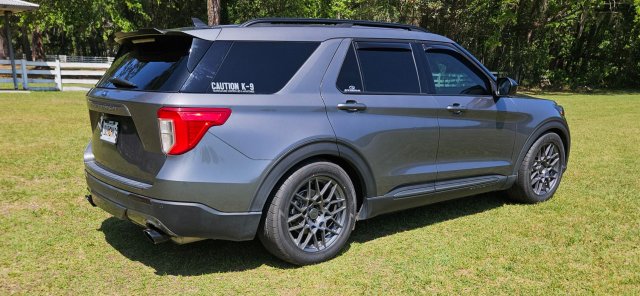

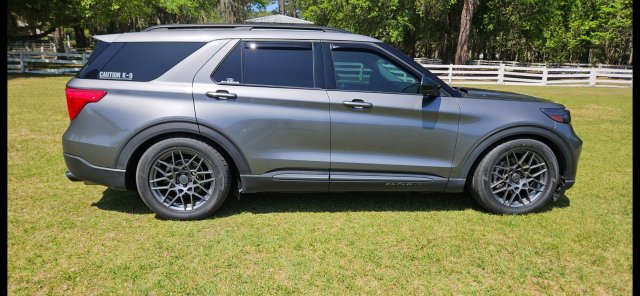

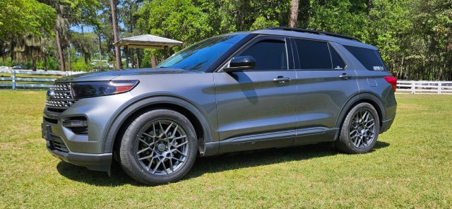

Won't be as flush as you might like.

Everything there will work just fine.
If I did the calculator right, it's another 17mm toward the suspension and 21mm toward the outside. I can live with that.
Just over a 1/4 inch in on the tire from a +30mm with a 305.

It will look better than stock but slightly less aggressive than the common +30 with a 305.
Such a small difference most people won’t notice it.
