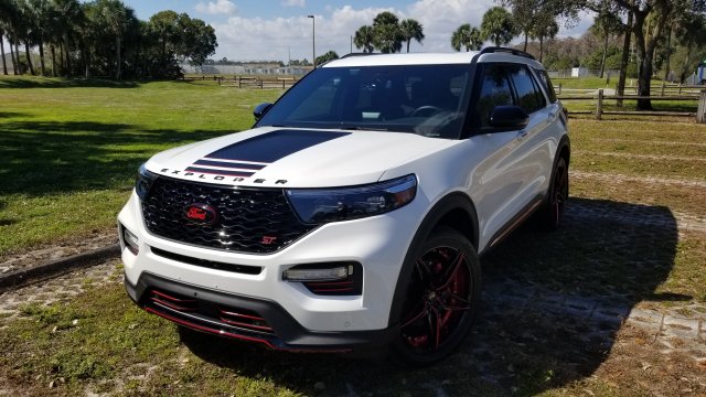

Has anyone removed and replaced a 2021 Ford emblem on the front grille..I looked at it for about 20 minutes and cannot figure out the easiest way to get to it. Has anyone done this? Any tips would be greatly appreciated.

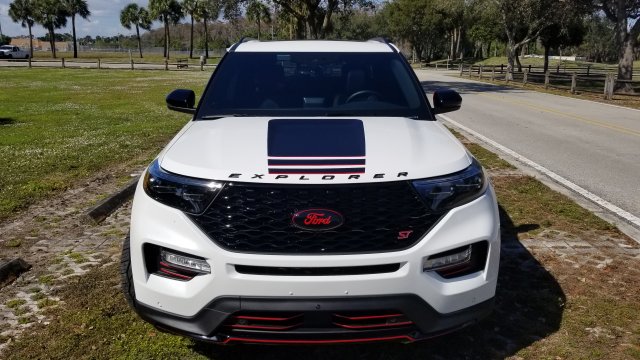

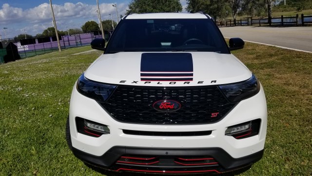

I actually used my 11 old niece Cassidy to get her arms in the slots below the Emblem and loosen the 10MM fake nuts. Hopefully she will be a future Gear Head. It took her about 20 minutes to get the Ratchet lined up. (I felt like the Mandalorian teaching Baby Yoda. LOL (1) Baby Yoda Tries to Fix it! Season 2x4 (cute Baby Yoda scene) - YouTube ) The same amount of time was required to install the new red unit. I took her for Ice Cream after and a speed run and we are good. !!! Child Labor works for me. It did cost me $11.00 at Carvel ;-(.. WTF? 20210127_121325.jpg 20210127_121316.jpg 20210127_121857.jpg

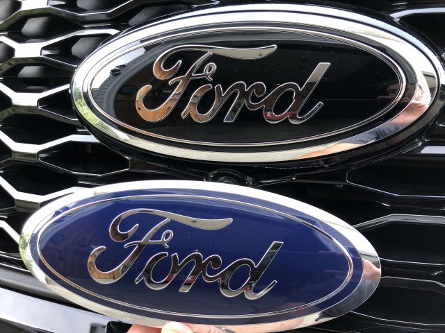

got the black ovals from Ford. The rear was easy. Took more time cleaning off the sticker glue than anything. But on the front the bumper cover took me a while. There’s two 10mm bolts connecting the bumper to the fender that were the hardest step by far.

Any chance of a link to the black oval?
