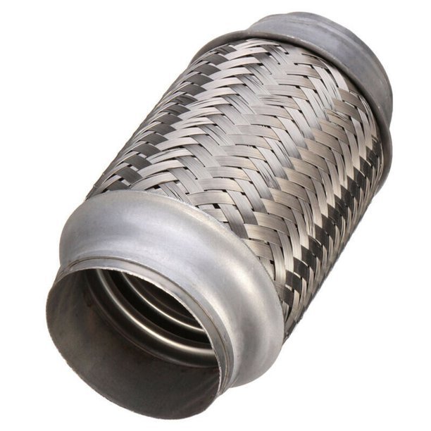

No, completely different design. They are a mesh and have been used for years. Why Ford decided to use the flex joint they now use is probably a Dollars and Cents issue but I believe it to be an inferior design. flex joint.jpeg

One of my OE flex sections failed after less than 3 years. If it's rattling, you can be sure it's going to fail from all that vibration/movement--just a cheap and crappy flex section. Since most of my exhaust is stock except axle back, I opted for the Lethal Performance mid pipe. Easy install and fits perfectly. Rattle gone.
