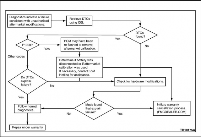

Ford has a very clear step by step protocol that a technician would have to follow if they feel a tune has caused damage to an engine. This is well documented in the Focus RS forums.
Ford will always cover their corporate ass.

Good information- would you be kind enough to summarize the protocol and tell us the experience of the RS owners?

I owned a RS for little while so as on this forum the RS owners are asking the same questions about tuning and dealers. Someone on the RS forum shared exactly what Ford would ask a technician check to see if the car is tuned or modified in any way. From air intake to flash count. All step by step. If I can find it online, I will share it. Of course, this type of scrutiny only comes up when there is a major problem.
65
38
Yellowknife, NT, Canada
Below is some info from that forum. I will keep looking.
"The dealer uses the IGNCNTR value stored in the PCM to detect if you have tuned the car."
