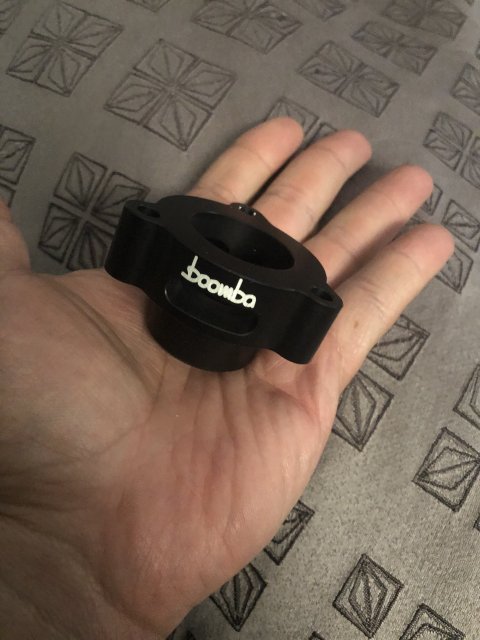

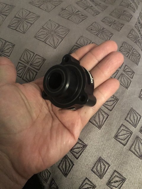

guys, i recommend the boomba vta adapter.. 89 bucks delivered, easy install, and it sounds great.. i will try to post a video of the sound when i get a chance.. however, if you plan on buying this, i suggest shaving about a quarter inch off the provided hardware.. they’re a bit long.. i wish they had provided a hex head bolt instead, but it’s fine..

When you install that Boomba VTA adapter, can you make a video of it? That would help us all that wanna follow!

i did not.. sorry.. there’s a video on youtube actually, but it’s pretty simple.. like i said, the three screws they send are a bit long..
