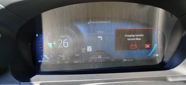

Great job finding this article. My vehicle is back in the shop for this very reason. It has been there 4 days! Apparently, the message isn't showing anymore. And since I mentioned to the shop this happened after a long drive, they put a 45+ miles on my vehicle to 'recreate the issue'. Luckily gas is cheap now.
The first time this happened, they just replaced the battery. The second time this happened, I was getting a dash error (see attachment) after a 100 mile drive. I hit OK 3 times but decided to redirect to my local Ford Dealership Service Dept instead of driving home. They mentioned something about a BCM needing updating but this article gets more into the weeds of the problem.
Thank you for finding this article. Why aren't they doing a RECALL on this issue?

The first time I had a battery issue the car simply wouldn't start. So it was OFF from the beginning.
The second time this issue happened, I was getting repeated dash errors about my battery about to fail while driving over 100 miles. I steered towards the closest Ford dealership & dropped it off. And that was after Ford put in a new battery to correct the first instance. This second instance should qualify if it is happening to enough Explorers out there. They also read how to fix the issue from a Ford Bulletin, proving this is a known problem.
