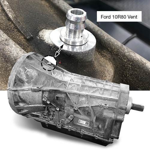

Does the 10R60 have the same vent as shown here on a 10R80? I'm wondering what happens if the trans is overfilled: does it cause issues, or does excess fluid get pushed out this vent?
Yes, it needs to be running, level and at operating temp to get a correct reading. If it's overfilled, the fluid will get on the planetary gears causing it to foam up and then it goes downhill from there! I'd imagine if you have fluid coming out of that vent it's overfilled!
