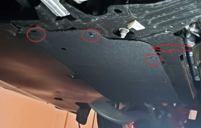

I went to change the oil this afternoon and found a couple clips and screws missing. Can anyone please tell me the correct part number for the screw and clip that I circled? I think the clip's part number is W712196-S300 but I am not sure. Thanks.
Does anyone know the part numbers for the metal screws, metal screw retainer nuts, and both round and square plastic clips for the L1MZ6P013A splash shield or at least how to find them?

I don’t know the part number, but I went to the Ford dealer parts department and told him I wanted it and he pulled it up on his computer and sold me the round plastic push pin, the one on the right side of your photo, for four dollars each. I bought two of them just so I can get it on now. The metal screw he told me just go buy it at a hardware store cause it’ll be cheaper than we’ll sell it to you for.
