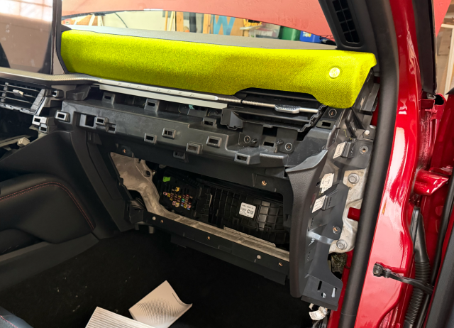

Does anyone have experience removing the highlighted trim piece? I was pulling pretty hard and it felt like it didn't want to move. Need to replace oem tweeters and not wanting to do custom a-pillars just yet. Info about this side and the driver side would be most appreciated, thanks. Screenshot 2026-03-26 at 4.04.35 PM.png

it is held in by 4 or 5 screws,.. the tricky one is on top to the right and requires removing the A pillar.
If that is your pic, you need to pull that metallic looking trim as well. Also the screen. it is a pain.

Wow… glad I didn't pull harder. Thank you for the info.
"Also the screen" do you mean I have to remove the screen to get access to the tweeters!?

If I recall, there's a screw for the trim behind the screen.
