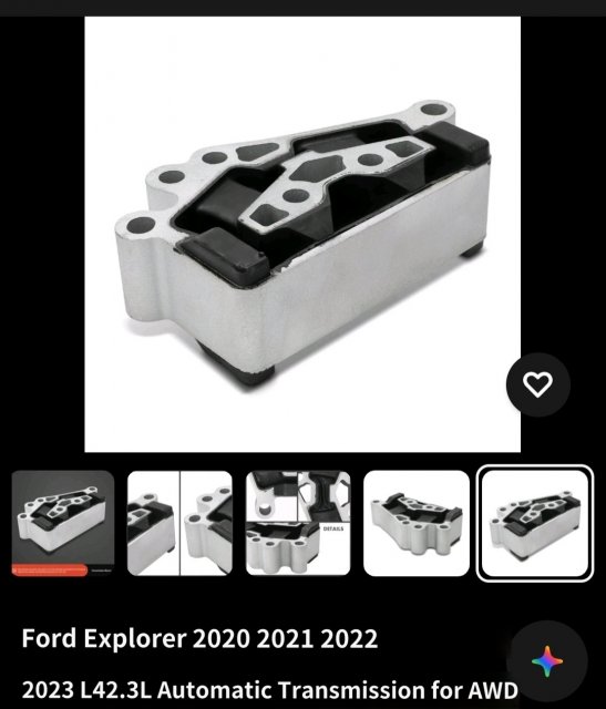

I almost got confused. Isn't it this product?
No, not the one. The ST and PIU version has a center alloy area that is more triangular. The right mount in the picture I posted.
