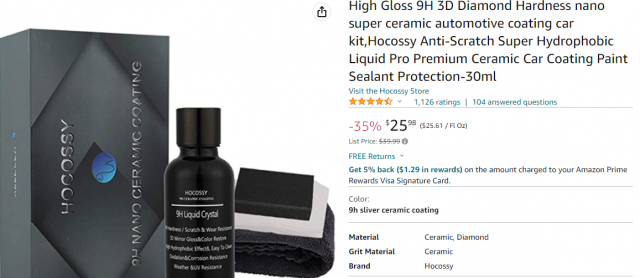

Is it possible to mess it up and do damage? I was reading ceramic coatings are for the pros
1,209
607
It really is pretty easy and this is a good product, been using it for years. Just make sure that the car is in a cool and in a dry place (out of the sun) and it is just like hand waxing a car. Do one section at a time and you are good to go.
Disclaimer. With enough practice, you can F-up just about anything if you try hard enough.:cool:

Disclaimer: that sounds like me :)
