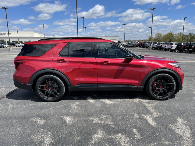

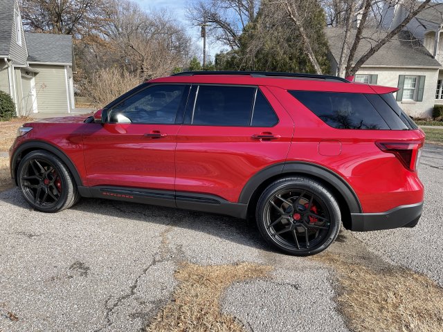

Started out with 10.5x22 +30 wheels and 305/35/22 tires. I found the wide 305 tire followed the road a bit more than I liked and the low profile 35 tire was a bit rough going over pavement cracks. I have since changed to 295/40/22 tires and it does not follow the road at all with the slightly narrower 295 tire and the taller sidewall definitely helps cushion the ride.
Looks Nice... did you just change the rim and tire size? Or did you lower it also?
This looks perfect. Assume you have lowering springs and still don't have issues? Looks like a 295/40R22 is about 31.3" OD vs the 305/35R22 at 30.5" OD but .5" narrower which I assume is where people get some rubbing.
I really like your setup! What wheels and tires are you running?

Those were gloss black BC Forged EH 309 22x10.5 +30. Looks best with a 305/35/22 tire like a Lionhart LH-5 (tire shown is no longer available since Covid) but a 295/40/22 also fits without issue.
